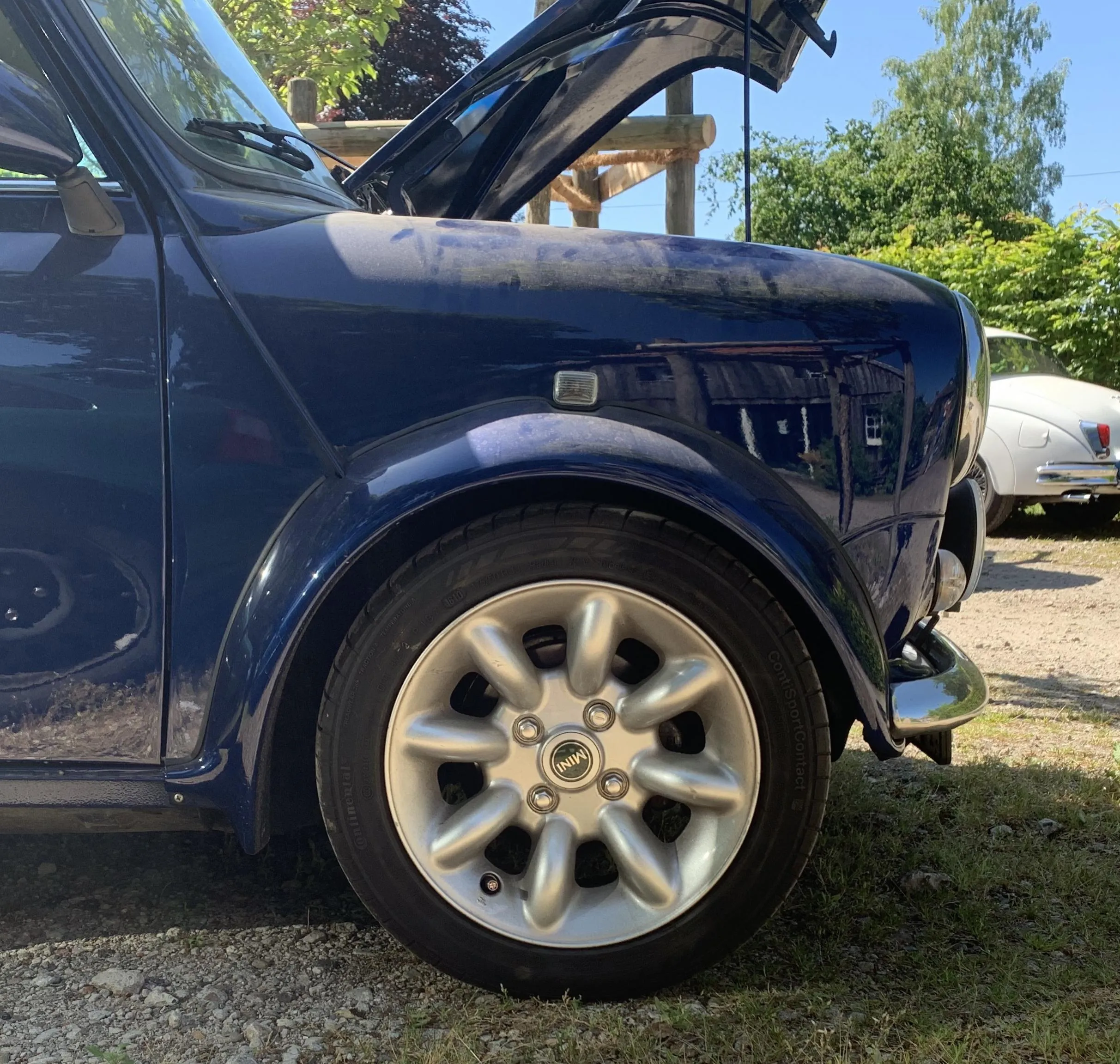

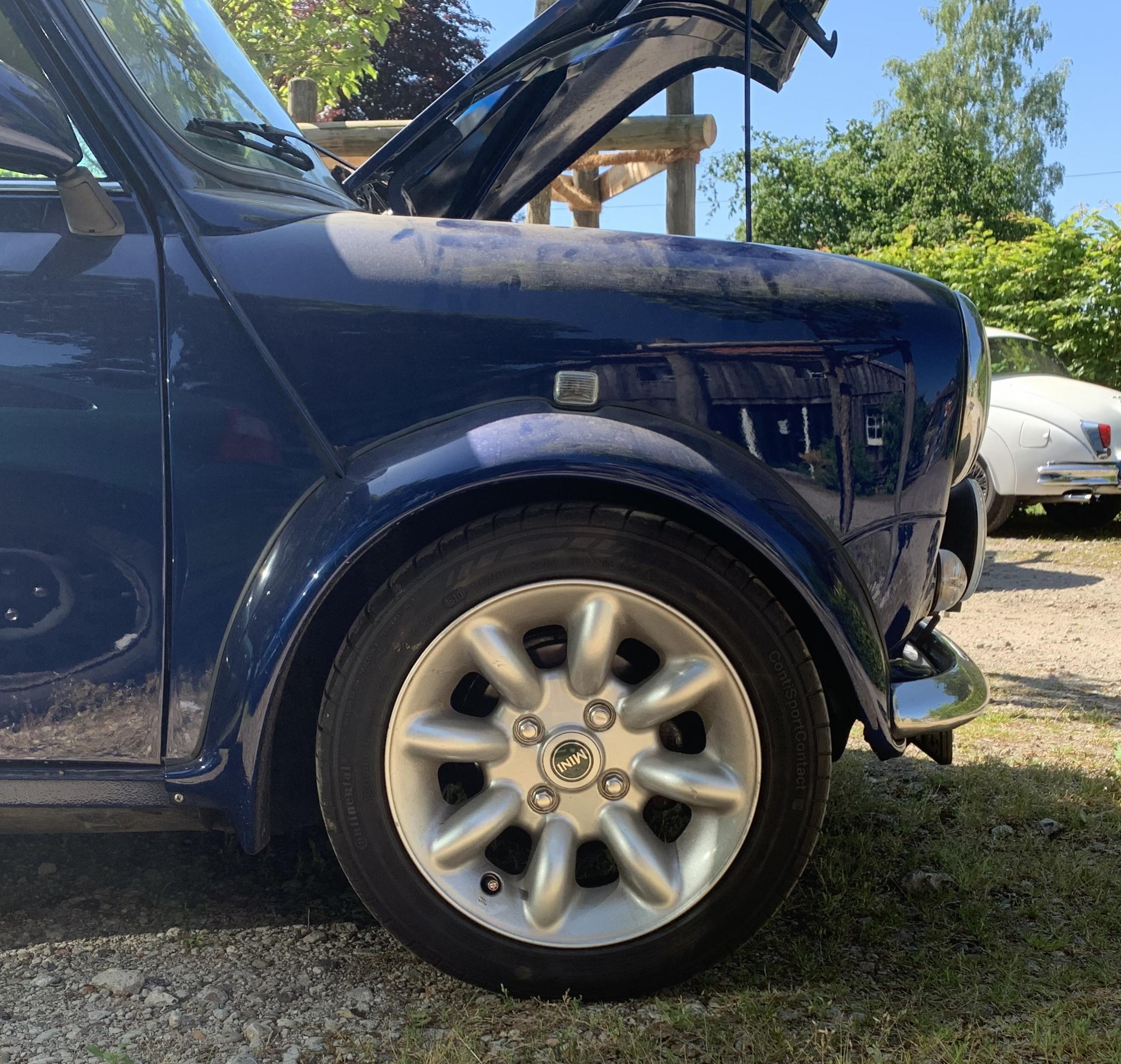

MPI - Sportpack zu tief?

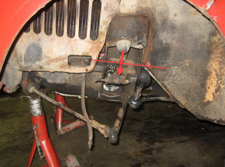

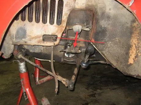

Wenn Du neue Gummis einbaust kommt er etwas höher und der Mini federt wieder.Gruss
you may find a spacer/washer between the knuckle and the Trumpet. this was a standard fitment on the Sports packs as they had raised suspension.
