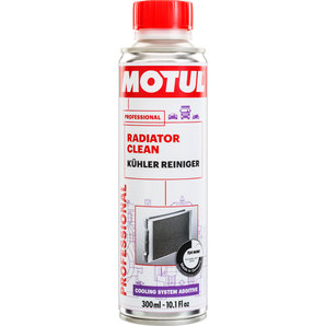

I have flushed out the engine with some Motul rad flush
https://www.louis-moto.co.uk/artikel/motul-…300-ml/10037698
while i was running the engine for the required 30mins i noticed some fuel coming from the Filter king breather.
