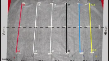

  • 6 Stück, von vorne nach hinten:
    1. Rot
    2. Weiß
    3. Weiß
    4. Schwarz
    5. Blau
    6. Gelb
    ...oder auch ...
    Zitat von minispares
    MK3 minis introduced a different headlining which was held up by rods rather than the MK1/2 type which were attached to a frame. There are five different colour codes on the 6 rods number one with red ends is EEB100060 number 2 and 3 is white ends are both EEB100070 number 4 with black ends is EEB100080 number 5 with blue ends is EEB100090 number 6 with yellow ends is EEB100100
